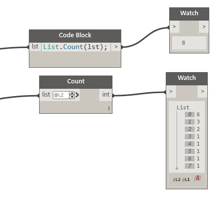

Hi, the level syntax is as follows:
List.Count(lst@L1) or List.Count(lst@@L1) if you want to keep list structure.
It was List.Count(lst@-1) before: https://github.com/DynamoDS/Dynamo/pull/7452

Hello.
I’m trying with Dynamo 1.3.0 but it doesn’t work. Any suggestions?
Regards,
Have you tried right click and node to code to see what the level activated node is converted to?
