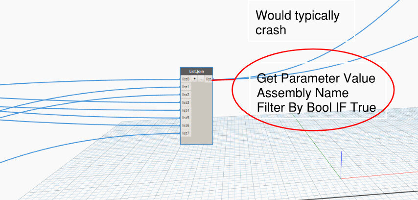

One of the graphs I am working on is adding Elements to Assemblies by BiMophs Element Intersects.
Towards the end of the could end up having 1000 Elements added to the multiple Assemblies. I think what maybe causing the Issue is that the 1000 Elements go through a series of Bool Checks to filter out by conditions. A wait-for node applied to the list of Assemblies to wait-for the its new Elements to be processed.
It is hard to tell because the graph crashes with nulls across the graph. When I break it down into sections everything works great, just when I put it all back together that’s when it likes to fail.

Organize the filters efficiently; do the largest set first, the second largest second, etc… It may be that this is better processed via C# or Python than multiple Dynamo nodes as with Dynamo nodes you process all the items then get all the items in two lists. Then you process all the items in one of the two lists again…
I like to think that it’s like splitting a dozen logs once and moving each of the 24 to a new pile, then splitting the 24 half’s and moving each of the 48 into another pile, then splitting the 48 quarters and moving each of the 96 eighths into a new pile. If instead you split the dozen logs into 8 pieces you could only have one new pile to make instead of three…
Jacob, I will try to filter out at the source of my Elements. I was trying approach of List.Join then doing a filter on bigger list as you suggested. I will try a different approach and see what I get.

I did successfully get my graph to run properly without issues. One of the things that I did is I broke up my filter closer to the source elements as opposed to one giant filter.
