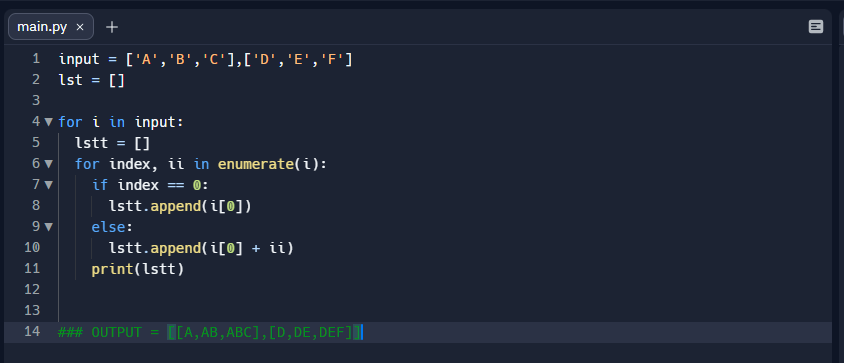

I would like to join sublists of strings in the way you can see in green below the following image:
As you can see I tried to create the code with no success…
Thank you so much.

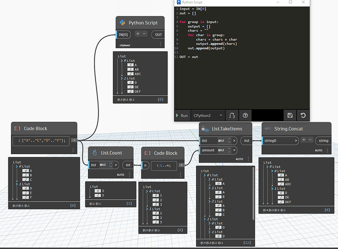

You can do this fairly easily with nodes as well. The issue with your code is that you’re not combining the current item with the previously combined items, only the first item.
Thank you so much @Nick_Boyts ! That it´s what I was looking for!
