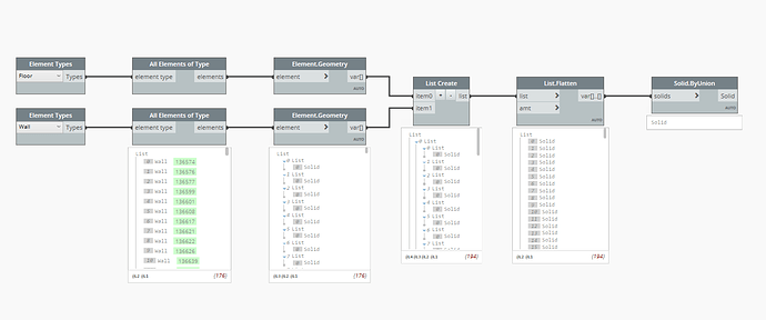

Do you want to join only the geometries ?
If so, and as Walls and Slabs geometries are Solids, i suggest you use the Solid.ByUnion node.
Thank you very much Mellouze but it does not work for me.
I intend to get a change about the volumes of the floors after joining or solid by union. Or the volume stays the same the model. Blue lines shows off something happening but it wont change the aparent volume.
