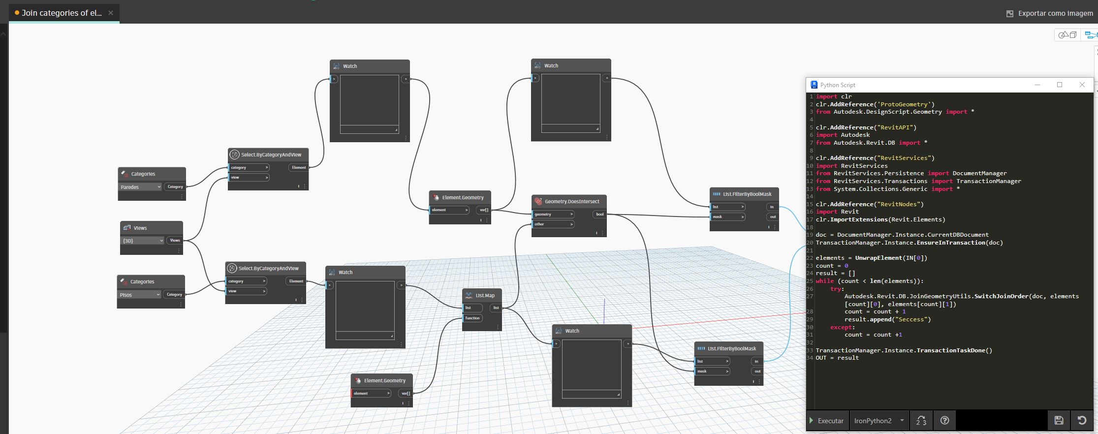

Sorry to bring up this topic again, but even searching the forum I wasn’t successful. I run the script but nothing happens in revit, it doesn’t show any errors, but it doesn’t execute what I need. Is there any other new package for such functions? Or can I improve this script? What’s wrong?
@cintiamiranda21 ,
at the first look i see that you run IronPython2. Did you install the corresponding packages ? IronPython2 and 3. its Revit2024?
a other topic can be you have to embed your python node in a costumnode and set lacing to XXX
