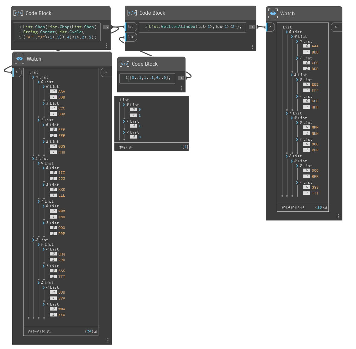

you need to chop indices by 1 and then flatten output by 1 to get and maintain your original list structure.
transpose the input list and access the required list by feeding the indices value into a matrix.
For example: indices values = 0,2,1,1.
Transpose the main input list and use list.getitematindex

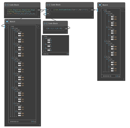

List.GetItemAtIndex(lst<1>,idx<1><2>)
See if this works
