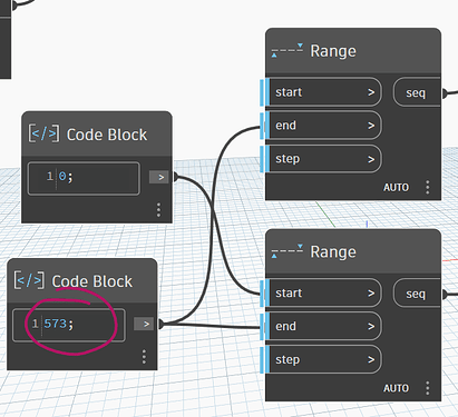

The index out of range error is because it is trying to get 573 items from a list that only has 532 things in it. In other words, this number doesn’t match with how many rows are in the spreadsheet.

These are symptoms of what I mentioned above - hardcoding values like this makes for a very brittle script. I would recommend taking a look at this example, which demonstrates how to read the Excel data into a dictionary and then pull it out from there. This approach is much more resilient to changes in the spreadsheet. If you get it setup correctly, the only thing you have to worry about is that the column headers don’t change over time (“Survey Name” and “Roadway Name” in your specific case). But the columns can move around, the number of rows can change, and everything still works.
