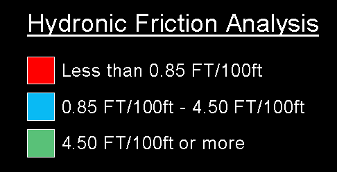

Is it possible to have Dynamo place a Duct Legend on a view?
I am already creating views and sheets with Dynamo, and now I want to create Analytical sheets that get a Duct/Pipe/Space legend on the appropriately. Is it available in the Dynamo interface to access the Duct Legends and place them?
Thanks!
-John W
@J.Wehmer as far as I know Legends are not exposed in Revit API so the answer is no. The only exception to that is the Analysis View and Analysis Legends. The API for that is located here: http://www.revitapidocs.com/2018/f6bf7b39-1fc9-58c6-5f25-b4b4b17cfeb4.htm I don’t think that’s what you are asking here for, so I think the answer is no.
@Konrad_K_Sobon, well that’s a bummer
I will keep looking for other ways to improve our workflow!
