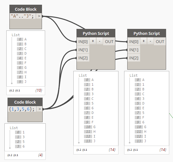

You’re exactly right. It’s a little more involved than just inserting items at the specified index.
Here’s the difference between inserting at the specified index (first python script) and inserting at the modified index (second python script).
dataEnteringNode = IN
originalList = IN[0]
newItems = IN[1]
indices = IN[2]
i = 0
for newItem,index in zip(newItems,indices):
	originalList.insert(index+i,newItem)
	i = i+1
OUT = originalList
The python code is the same except for the increment variable i to take into account the shift of elements with each insert.
