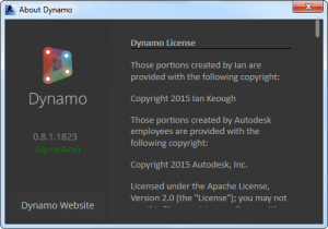

Does this help?

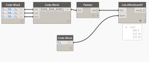

“AllIndicesOf” not available when I search for it. Any Idea why that is?
Which version are you using?
dynamo 0.8.1.0

Just tried a fresh install of the stable release of 0.8.1 and it appears to be there.
But in the meantime here is a method to use. I will also publish this to Rhythm today.
Fresh Install fixed the issue of missing nodes. Thanks
