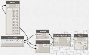

I’m pretty sure you can feed it a list of indices using List.Map …

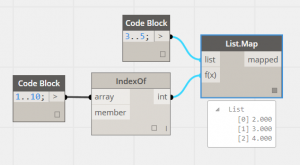

I just tested w/ List.Map, but couldn’t get what I expected. Am I doing something wrong?
이미지 2
MappingIndexOf
Seems it is a limitation of the node. Hopefully the developers will look into it. In the mean time, you could try an approach similar to this:
2015-02-03_150607

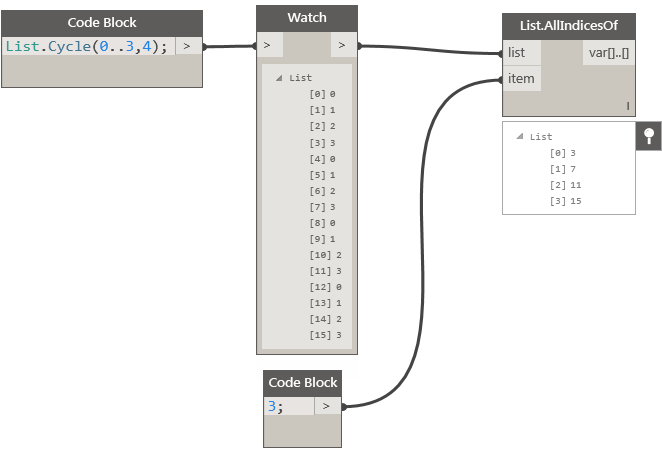

Is there any updates if this is fixed? I think this is what I am looking for,
I guess it’s updated by List.AllIndicesOf:
list indices
This solves the problem I had, exactly what I was looking for.
