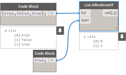

How to get incidences of boolean list for True only?
so when I have
[0] True
[1] False
[2] True
I receive
[0] 0
[1] 2
<br class=“Apple-interchange-newline” />
