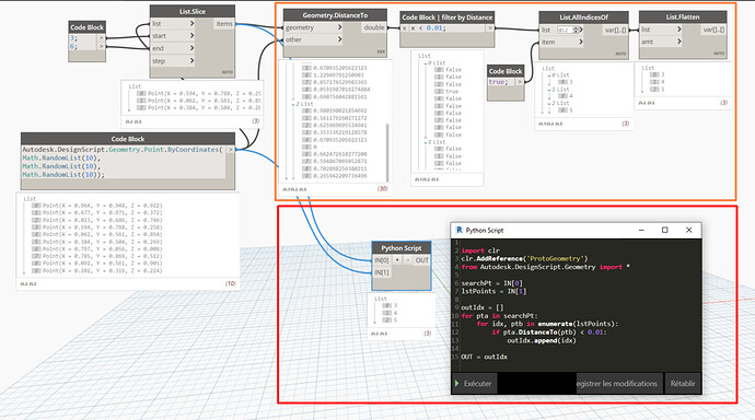

I have a list with 12 points I have 4 points from with list. I like to know the index of the these 4 points in the 12 point list. List.IndexOf or List.sortByKey dose not seem to work on Points.

IndexOf should work with points. Are your points exactly the same? Try rounding the XYZ values in both lists and see if you get intended result.
Hello @johanna.ronnerBMXSJ

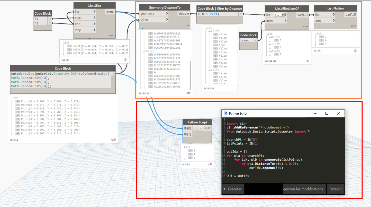

assuming that the points are not identical here is 2 solution using DistanceTo() method
Brilliant! Thanks.
