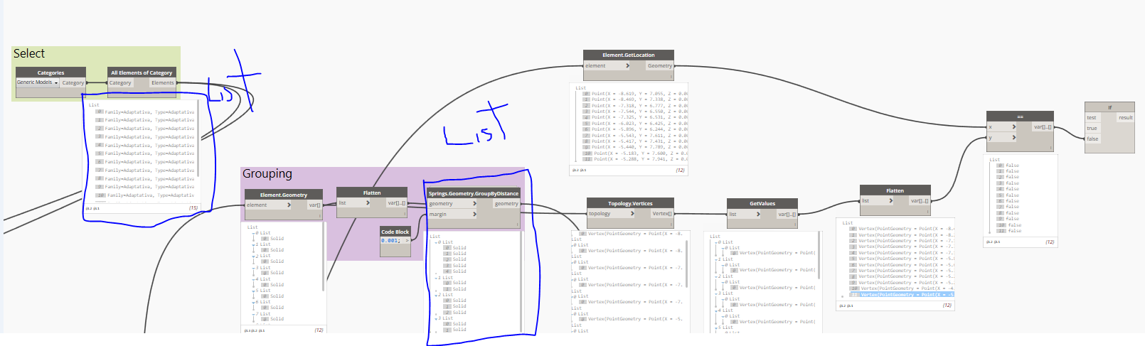

So basically I import some geometry from revit. (stops being native goemtry) and I continue doing some sorting in this Data, Where Im stock at the moment is that i want to match the index from the original geometry to the one that i ordered after.
Any ideas or guidance on this one, thanks

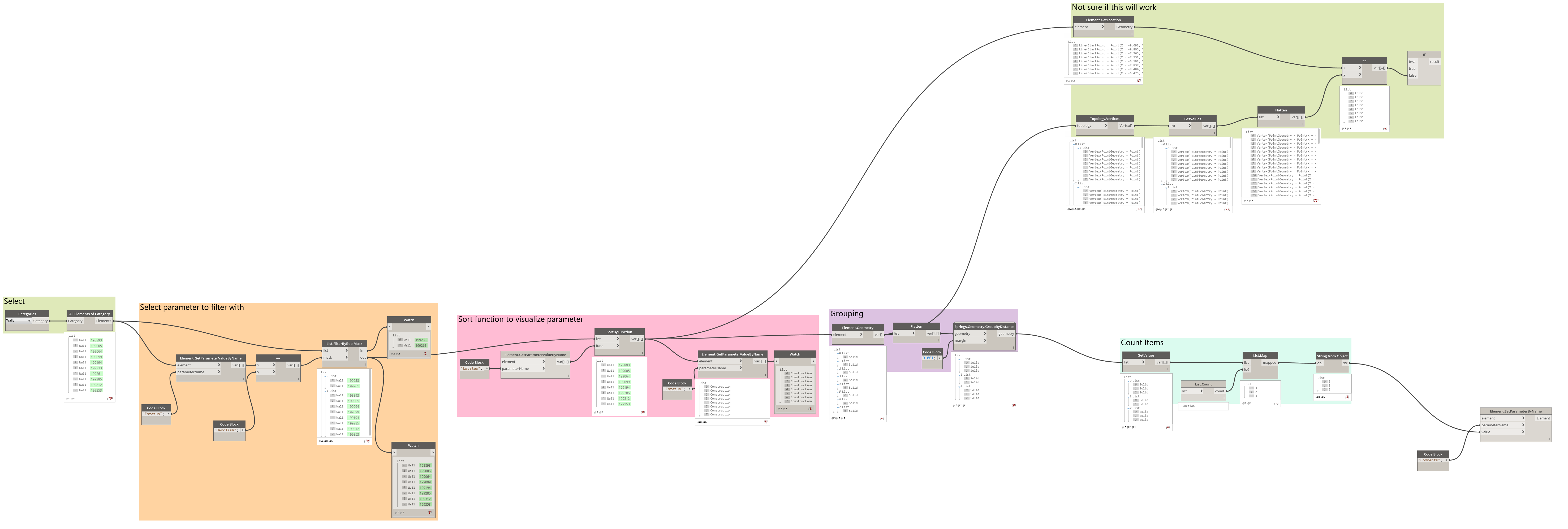

Im sharing the dyn file and rvt file thanks for your help sorry I couldnt share before.
Please take a look to the script. Basically what i want to do is to match the elements from the first list to assign the number as a parameter back to the elements. The problem is that I havent found a solution to match the index for the elements.

  2. You have indicated the first list of elements as the one coming out of “All Elements of Category” but in the dyn file you are filtering the walls based on the parameter “Estatus”

Im trying to match the list from “sort by function” that gives me the ID from the elements, to the list from “GroupByDistance” that contains a list of the elements group.
So basically the order of the list are different but they are “same elements” So I want to figure out which ID belongs to each group.
