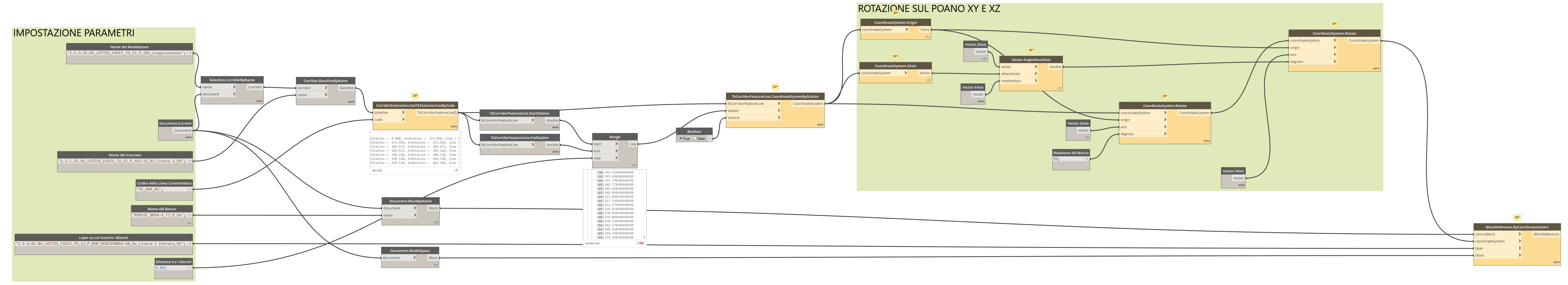

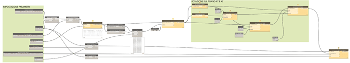

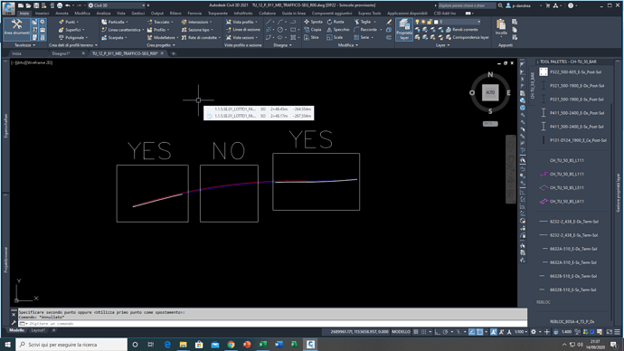

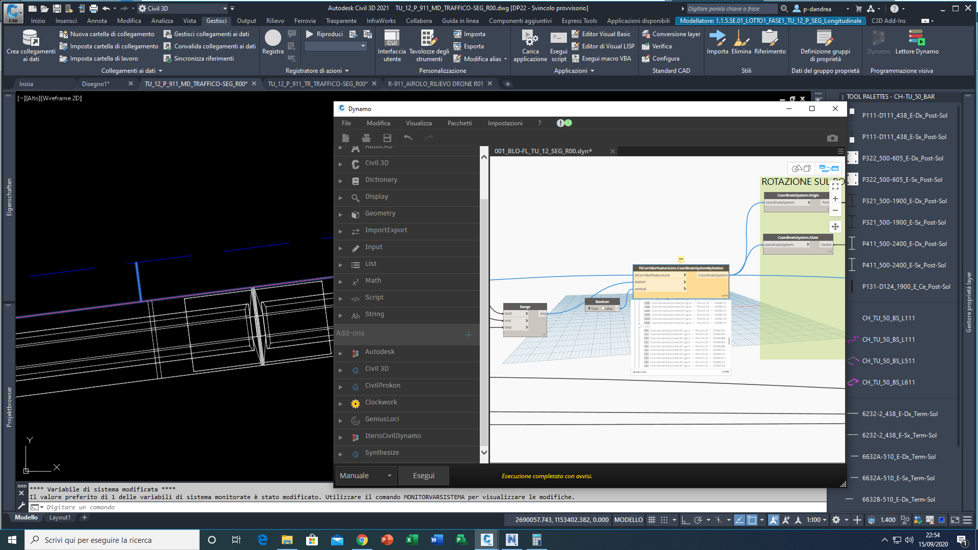

Hi everyone, I need to insert a block on a corridor featureline. The featureline is not continuous but is divided into three unconnected pieces. I don’t understand why it puts the block on the first and last feature line but not on the middle one. I think that the problem is in the selection phase because it selects seven featureline lines and not three and some have a coincident beginning and end.
What is the warning message on BlockReference.ByCoordinateSystem?
Hi mzjenzen the message is the following: "Warning: BlockReference. ByCoordinateSystem operation failed.The value cannot be null. Parameter name: coordinateSystem "
