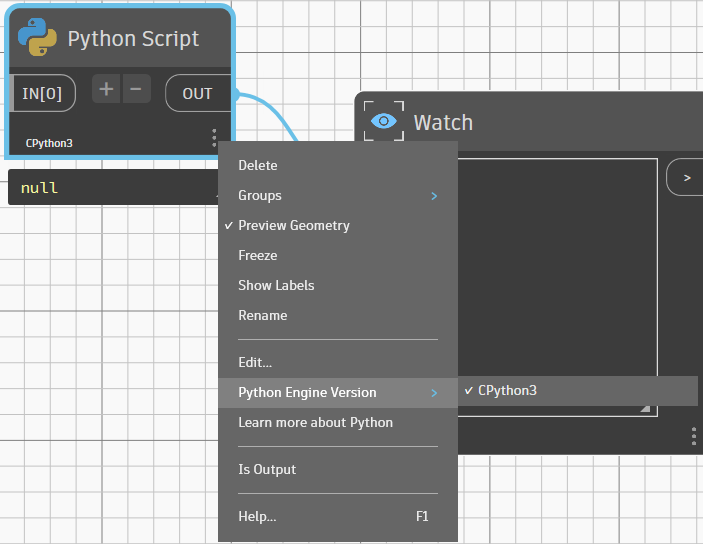

Hello! It looks like I only have CPython3 available. I am currently on Revit 2025, Dynamo Core 3.3.0, and Dynamo Revit 3.3.0. Do you think I need to wait until I get an update? Is there a workaround?
Install the correct version for your system from the Dynamo package manager. Read the description for the package carefully and ensure you select the right one.
Oh, I see. The PythonNet3 Engine is a package right now. I didn’t catch that earlier. Until it is in Dynamo by default, I may not realistically be able to use it. My company really wants to avoid the use of packages, because they need updating for each individual user and reduce stability.
It seems like “import System” isn’t going to work on the CPython3 engine. So the directions forward are use the PythonNet3 Engine package or avoid using assemblies/packages that use “import System”.
