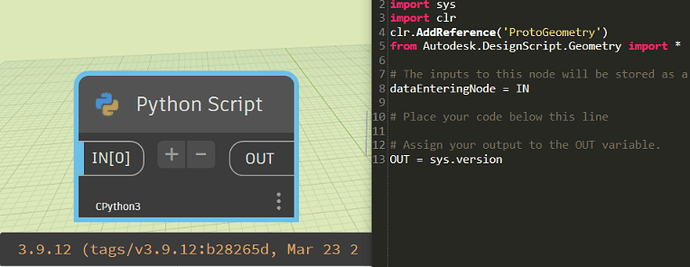

Can you confirm the Python engine in Dynamo for Revit? May be that PIP is set up to push to the wrong directory.
see here (bottom of page)
