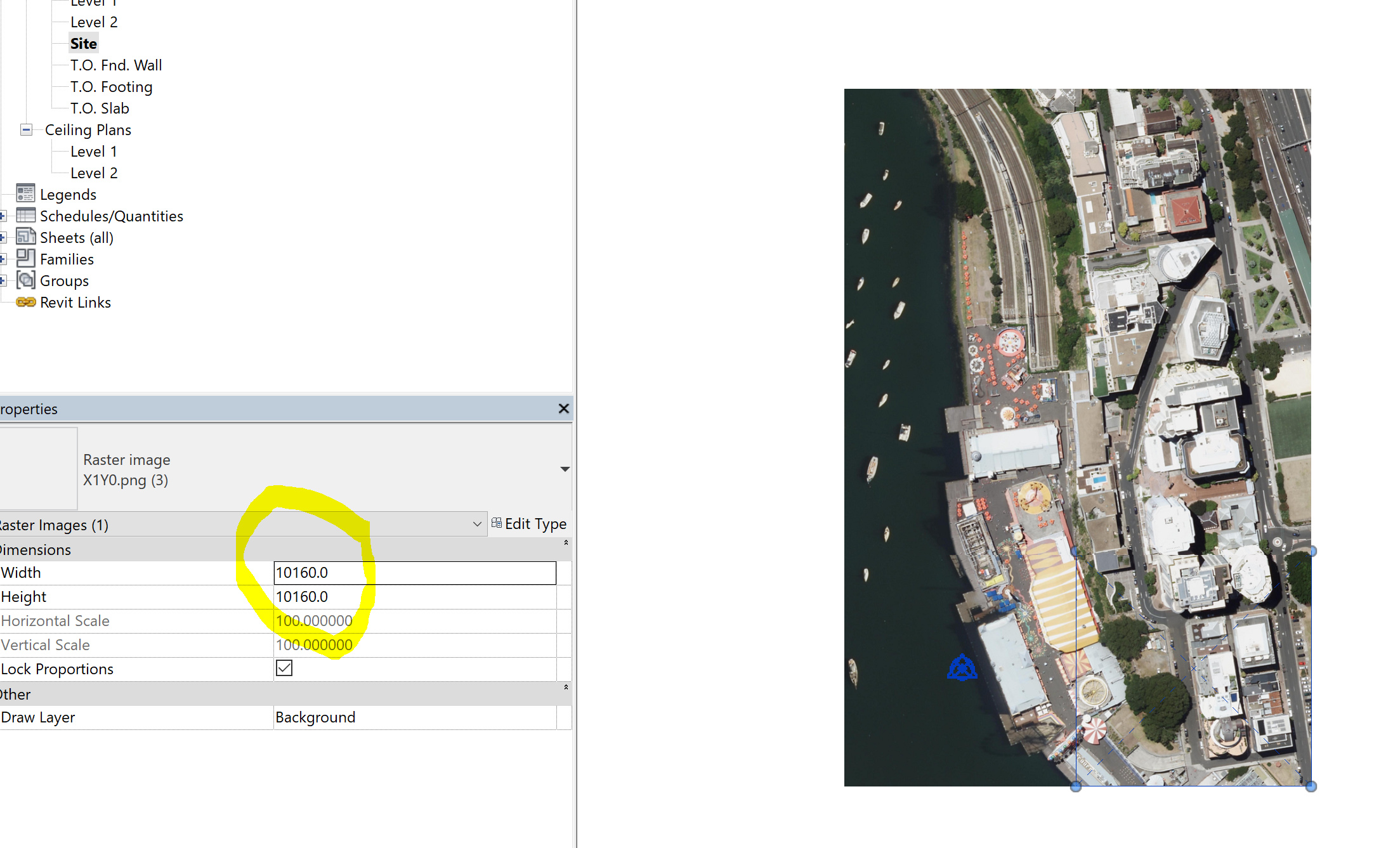

This is the script thus far, but fails at the final hurdle, not sure why?
A single file is fine, but of no use for this exercise.
It works for me (but, yes, it is slow)
Check your lacing- shortest will stop when the shortest input runs dry
Incidentally, I did notice a problem with the image scaling- comes in at 101.6m rather than 100m
If you have thousands of images, it may be easier to glue them together first- I’d recommend QGIS for this
I did get it to work, but had to lace the final node, like you did. I found that out myself.
