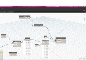

I have got all the information from Revit into Excel, I have changed the BH parameter in Excel and tried to bring it back into Revit.
It is reading the parameter correctly as I set them all to be 1000 in excel but then I am getting this error.

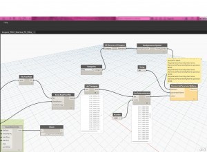

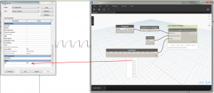

If I use this method it works but I will need to select the family type for everyone and I have over 500 different ones.

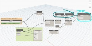

Christopher, There is a node called Set.ParameterName(Type or Instance) from Rhythm Package you can change all the family types of your category.
Below is an example of the node. Good Luck!
