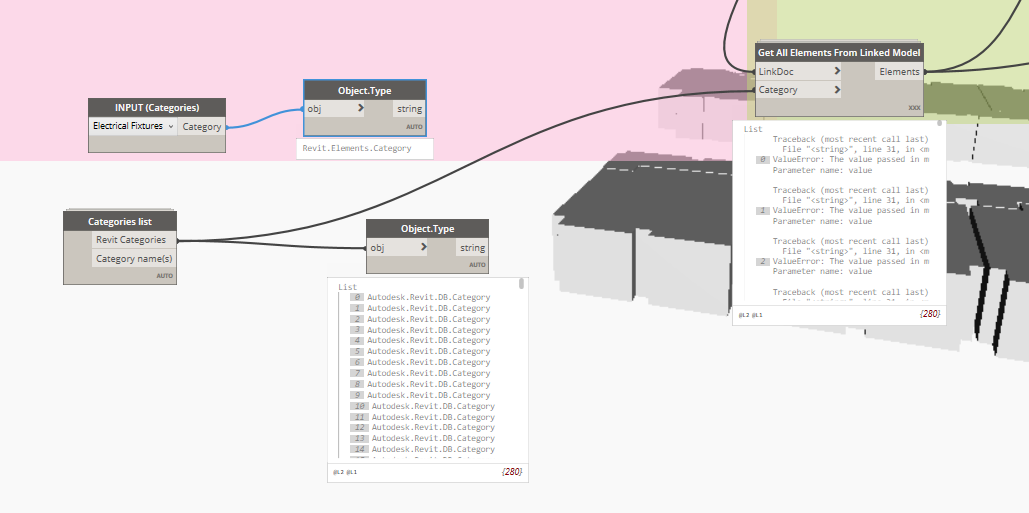

I am trying to get all categories from a linked file. It works when I use OOB revit nodes but I could only retrieve 1 category at a time. I tried getting all categories from data-shapes packages but it didnt work.
I thought it might be due to the object data type, check out the image below.
“Revit.Elements.categories” VS “Autodesk.Revit.DB.Category”
Any advise would be cool

Try the same graph in 1.3. This may be due to the Datashapes package not having been updated.
Alternatively you could try to manually create a list of categories and pass that into the working node.

Input “Category” at archi-lab custom node is expecting Revit.Elements.Category. The easiest way is to use Category.ByName node after “Category name(s)” and connect the values to “Category” at custom node. Cheers!

Thank you so much for your help! I think the list of categories should work for me :slight_smile:
