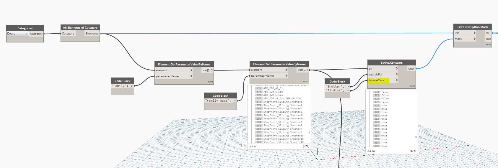

I trying to filter out some doors by family name, Why “ignorcase” is didn’t work?
thanks,
ignoreCase expects a boolean (either True or False). If your searchFor
input is “Shutter” and your ignoreCase input is True
, it will match both “Shutter” and “shutter”. If you are trying to remove all inputs which contain “Shutter” and “Sliding”, you will have to use an additional String.Contains node for the second string.
