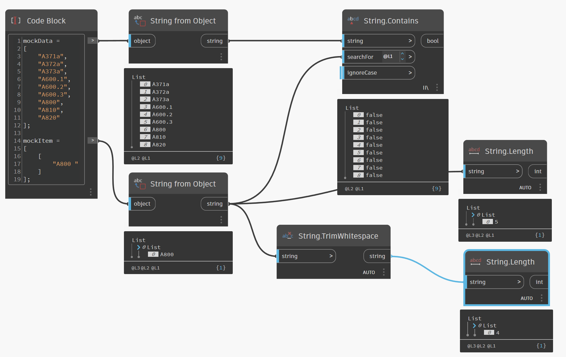

I cant grab this sheet with a bool mask or item at index?
Trying to prevent duplicate sheet creation from excel sheet list so we can run the same excel file over and over, updating our sheets but not duplicating ones we already have.
Every other sheet number is filtered out by a get all indices node. A800 is being missed. Tried running a bool mask on it after the fact. Still wont get filtered out. Am I missing something obvious here?

It looks like there might be an empty space on the end of your string that you are searching for. Use the string length node to check as below:

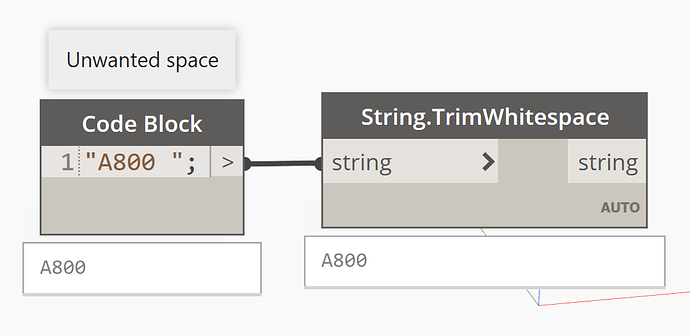

It seems your “searchFor” string possible has a whitespace at the end.
From your selections it seems that your “searchFor” string has an unwanted whitespace (or 2) at the end. Please try String.TrimWhitespace :smiley:

Hi @J_Sanford - Looks like both @haganjake2 and @Daan found the problem :smiley:
Your original solution requiring the keeping of List Levels will work when that space is removed. Note you can use the String.TrimWhitespace node to help here.
Also, feel free to use the Object.Type node lavishly as it will tell you the type of data flowing through - in your second example your data in the top List.Flatten node looks already to be strings, so you can remove the String from Object node entirely.

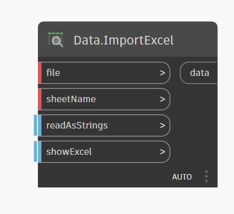

Knowing how the data comes in is useful too, so using Object.Type nodes lavishly will help educate you on that. Side note, on the Data.ImportExcel node you’ll be able to simply feed in a true boolean into readAsStrings to get the data returned to you as a string.
