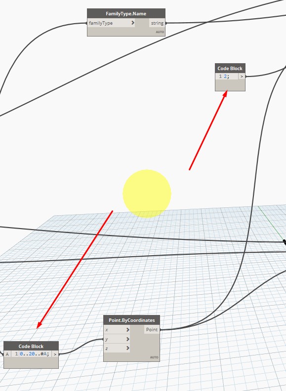

How you create your automatic legends
I record many times to reduce the size,I don’t know the 安全设备 is what you mention as Safety device or 安全装置.I place one family instance,try to check them.
If it’s not,you may try to do it manually,dynamo just make it automatic.
I’m sorry I didn’t understand
renew legend(Revit 2022).dyn (77.1 KB)
Finally I found the reason,your component is to small,I change the position of each legend and textnote.
hmmm ok ^^ thx so much
all is good
