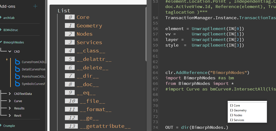

Thankyou for your response @Thomas_Mahon but while using the same how do we access CAD functions??
i was using the same as u mentioned above but getting error no module with that name so if u could shed some light…??
Because you imported BiMorphNodes as ‘bm’, now you have to call it using ‘bm’.
So use OUT = dir(bm) and you should be all set.
@jacob.small as bm that’s commented out and even in the dir u can see the output here
And under nodes you see?
OUT = dir(bm.Nodes)
Repeat until you have a handle on how the codebase is structured.
It does not load for me, why? I am using Dynamo 2+ of Revit 2021
Have you updated your user name in the path?
EDIT, your screenshot does show your name. Make sure bimorphNodes is installed in the 2.6 folder.
Yes, the screenshot shows where is the dll file installed in my computer for the dynamo version and package version, file path is different than the example in this post as you can see because i didn’t find any folder in my computer with the package, i think should work as it is
