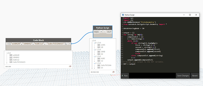

hi @vanman
is this what you’re looking for:
thanks viktor, but I dont think so. Or I’m typing something wrong. I dont know python but I think I’d maybe need a isnumber or isdigit method to get it to split at the first thing thats not a number from the back
import sys
dataEnteringNode = IN
output = []
for string in IN[0]:
	compoundlst =  []
	i = len(string)-1
	while i>=0:
		if not string[i].isalpha():
			first = string[:i-1]
			second = string[i-1:]
			compoundlst.append(first)
			compoundlst.append(second)
			break
		else: compoundlst.append(string)
		i-=1
	output.append(compoundlst)
OUT = output
Ok, my bad. And isalpha isn’t gonna help in this case.
you can give that a try:
import sys
output = []
numbers = ["0","1","2","3","4","4","6","7","8","9"]
	i = len(string)-1
	rest =[]
	digits = []
	while i>=0:
		if string[i] not in numbers:
			rest = string[:i-1]
			digits = string[i+1:]
			break
		i-=1
	compoundlst = [rest,digits]
OUT = output
you don’t need the protogeometry import obviously, but I was too lazy to remove it

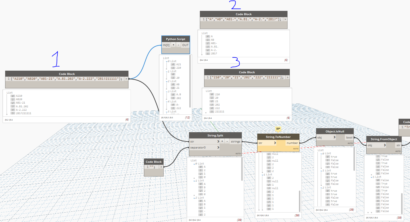

thanks victor. I might be explaining poorly. I’m trying to find a method that will look at a strings characters from reverse and find the first thing that isnt a number and then split it. So my 1 list would split into the 2 and 3 lists I’ve done as an example.
Below stuff is me trying to work it out with dynamo which is tricky
Got it… is it iron clad? I’m not sure but stoked
yeah, if you need them as separate lists there are multiple ways to go:
I guess I should’ve shown that earlier
Thanks Victor. The first list in yours should be.
  1. 10AB
  2. A1B-C
  3. A.B1.
  4. aabbcc
  5. a
the other list the left over numbers

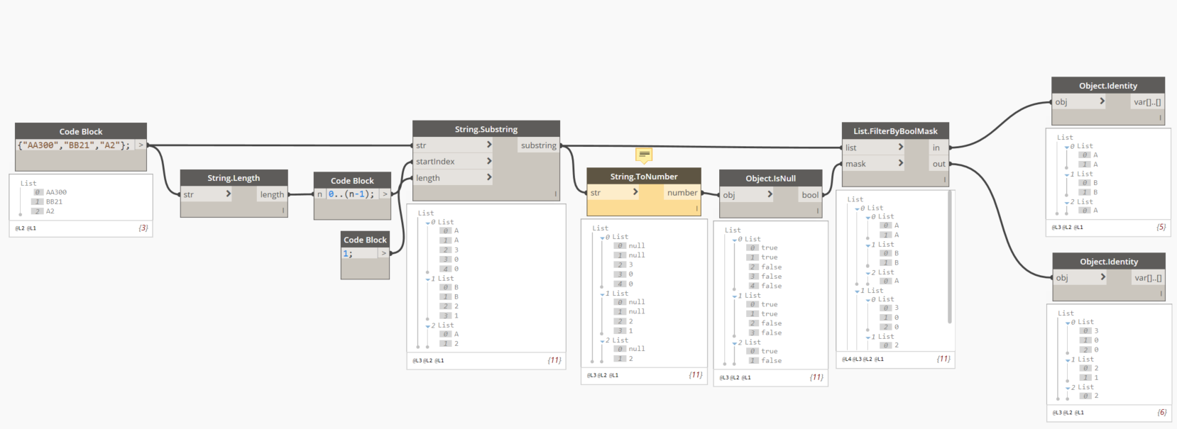

Hi @vanman , try this:
split = String.Split(x,"");
to_numbers = List.Clean(String.ToNumber(split));
null_to_str = to_numbers==null?"null":to_numbers;
rank_check = List.Count(null_to_str<1>)==1?"not null":null_to_str;
null_idx = List.Clean(List.LastItem(List.AllIndicesOf(rank_check<1>,"null")<1>));
null_replace = null_idx==null?-1:null_idx;
count = String.Length(x)-(null_replace+1);
lst1 = String.Remove(x,null_replace+1,count);
lst2 = String.Substring(x,null_replace+1,count);
out = List.Transpose([lst1,lst2]);
