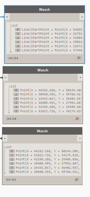

1st consists a list of curves.
2nd consists list of a point on each curve from the 1st list
3rd are sorted points equal from the 2nd list of points but from another curve.
How to sort the 1st list based on the points of the 3rd list?

I don’t want them to be sorted by default. The result I was hoping from the first list should be according to the order of the third list, which is 0,5,4,3,2,1 of their index. But i is not always in that order since I have other set of line/curves with a diffirent order of points and numbers that has random order
use the nod “List.FirstIndexOf” to retrieve the index of the 3rd list in the 2nd

I managed to find it on this forum, just use IndexOf and List.Map. I should have search through the forums first.
Glad to hear. Can you post that portion of the graph so others can learn from this post?
