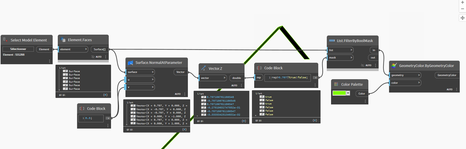

hi iam tring to host elements using dynamo using node familyinstance.byFaceAndPoint
but i cant exactly pick the bottom face as seen in picture
the input of Surface.NormalAtParameter is the output of Element.Faces

Firstly use a Vector.Z node to get the numerical value rather than convert to string, then use approximate equals ‘==’ node (two wavy lines icon) to match to -1

iam new to the forum and dynamo so may you please provide a photo with the nodes connected
As was noted above, this is a common question and answers can be found via search. One such example (for top faces instead of bottom - you’ll have to change a bit of formulas):
I think this node is worth exploring for this case.
