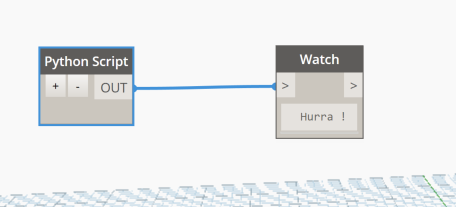

How to run it repetitive?
How can i make it repetive like “hip,hip,hurra” need i a empty list to append my strings?
for hurra_counter in range(1,4):
    for hip_counter in range(1,3):
	    OUT = "Hip"
    OUT = "Hurra !"

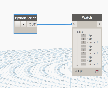

2020-08-04_12h51_05
How about this?

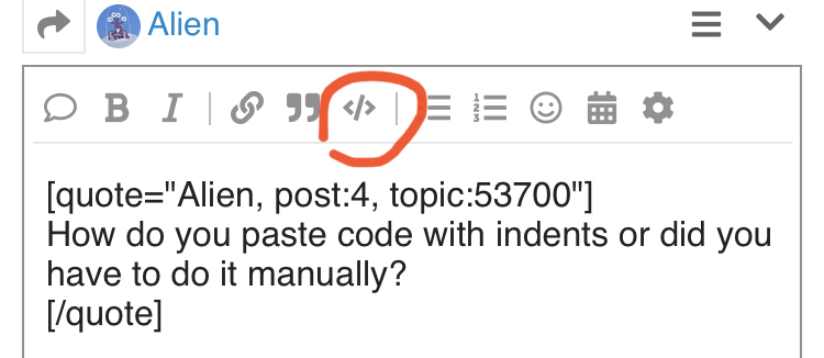

How do you paste code with indents or did you have to do it manually?
so it is no need to store the strings in a variable, i can append them direktly!
and the doubling of “x” doesn`t matter, because they are in 2 diferent loops?
