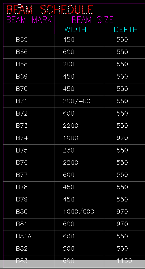

Hi All,
How to place different types of Beam by dynamo ver0.6.2
