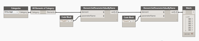

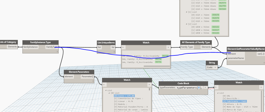

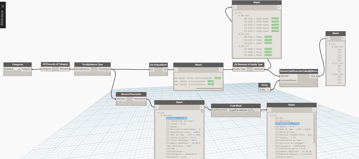

How to get a type parameter (cost or manufacturer, for example) of all elements of each type present in the project?
I want to get the cost of each element present in my project, but I know that the “cost” is a type parameter. So, I can not get it with Element.GetParameterValueByName.
How do i do that?
PS: “custo” is cost and “fabricante” is manufacturer.
just select “Type” parameter first and then ask for “Cost”:
