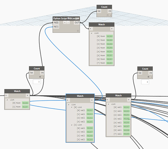

I have two List data.
But I want to make “List A” length and the “List B” same.
How does the process ?
Thanks!

Hi Dornan,
It would be better if you can be more specific what exactly your looking for. Are you looking something like this:
I am currently using this method for processing.
If there are other ways, please use the Node and then inform.
Thank you ~
You could use the “List.OfRepeatedItem” node with lacing set to longest:
Thank you reply
