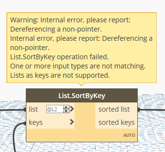

I tried it, the run started but it keeps on running… I force quit the program, tried again, but it just keeps running/appears to be ‘stuck’…
and yet there is not much calculation

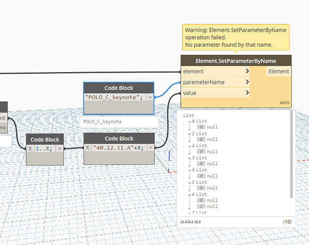

Yes i downloaded the dynamo file you uploaded and it says ‘no parameter found by that name’ and there clearly is a parameter with that name… I don’t get why it’s giving that error…
is it a parameter type or an instance?
Not to belabor the point, but…
Would it help if you have the revit file?
Okay So I guess my Height and Width are now instance parameters and my keynote is not. Is there a way to make the keynote an instance parameter? Because up until now I’ve only seen it for dimensions…
Go to family and change that parameter to Instance :slight_smile: . I didnt want to suggest that, because i dont know your company policy about parameters :slight_smile:
Yeah I just talked to our BIM expert and he said the same, we just changed the keynote to instance, I’ll run it again and let you guys know!
For some reason, still an error…
And they are all instance parameters now…
