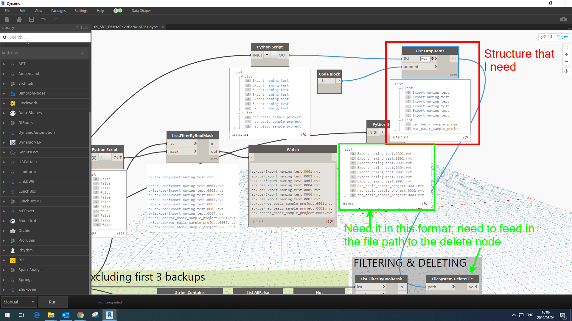

I have a script to delete backup files from folders, with a deep search function included in this. What I want to do is be able to isolate Revit files (Which I have done), but then I need to differentiate between different revit projects in the same folder…
For Example I have:
“Test Project.0001”
“Test Project.0002”
“Test Project.0003”
“Test Project.0004”
“Test Project.0005”
“Test Project.0006”
“Test Project.0007”
Then in the same folder I also have:
“Another Project.0001”
“Another Project.0002”
“Another Project.0003”
What I would like to do is be able to put as many different projects as I have in a folder into separate lists, get the total number of backup files for each project, and delete all of them except the last 2.
So in the above example I would only be left with [“Another Project.0002” “Another Project.0003”] and [“Test Project.0006” “Test Project.0007”]
I can do most of this, but I don’t know how to isolate the different project files into two separate lists so that I can exclude the last 2 items in the list from the Deletion.
Any assistance or direction with this would be really helpful!

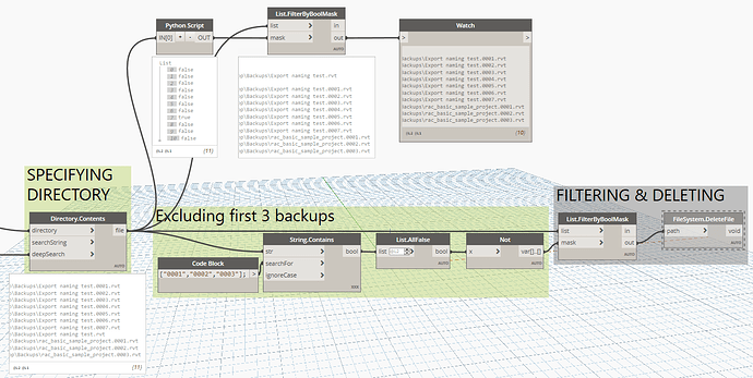

PS: Ignore the “Excluding first 3 backups” group, no longer going in that direction.

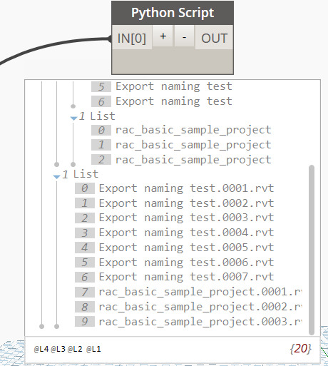

However, this also explains my problem better actually. That Project file name is going to change very often, as I want to run the script on several different folders, so there will always be different project names in the list. Do you think there is a way to grab the name of the project file in the list, then use that to feed into this section “if el.startswith(“rac_basic”):”, replacing the “rac_basic” with whatever the file name might be?
If not, I really appreciate what you have given me so far!
import sys
sys_path = r"C:\Program Files (x86)\IronPython 2.7\Lib"
sys.path.append(sys_path)
import os
from os import *
directory= IN[0]
files_in_directory= listdir(directory)
z=[]
test=[]
output = []
for element in files_in_directory:
if element.endswith(".rvt"):
if len(element.split(".")) >2:
output.append(element.split(".")[0])
liste = [[] for i in range(len(set(output)))]
for i,x in enumerate(set(output)):
for elem in output:
if elem.startswith(x):
liste[i].insert(i,elem)
OUT= liste
Once again, so so close, it is the exact structure that I need to use and that I am looking for, but I need that exact structure in a file path format, I think the current output is a string?
If you look below, I am going to take the actual files, drop the last two items, and delete the rest. But to use the node, I need path’s as an input.

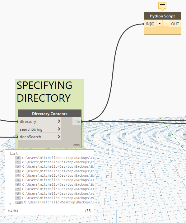

Curios though, as all the code worked before on that node that I was feeding in, and now all of a sudden it stops. The reasons I took it from the “Directory.Contents” node is because that node has the ‘deepSearch’ function… With this method, I guess I would lose that functionality?
