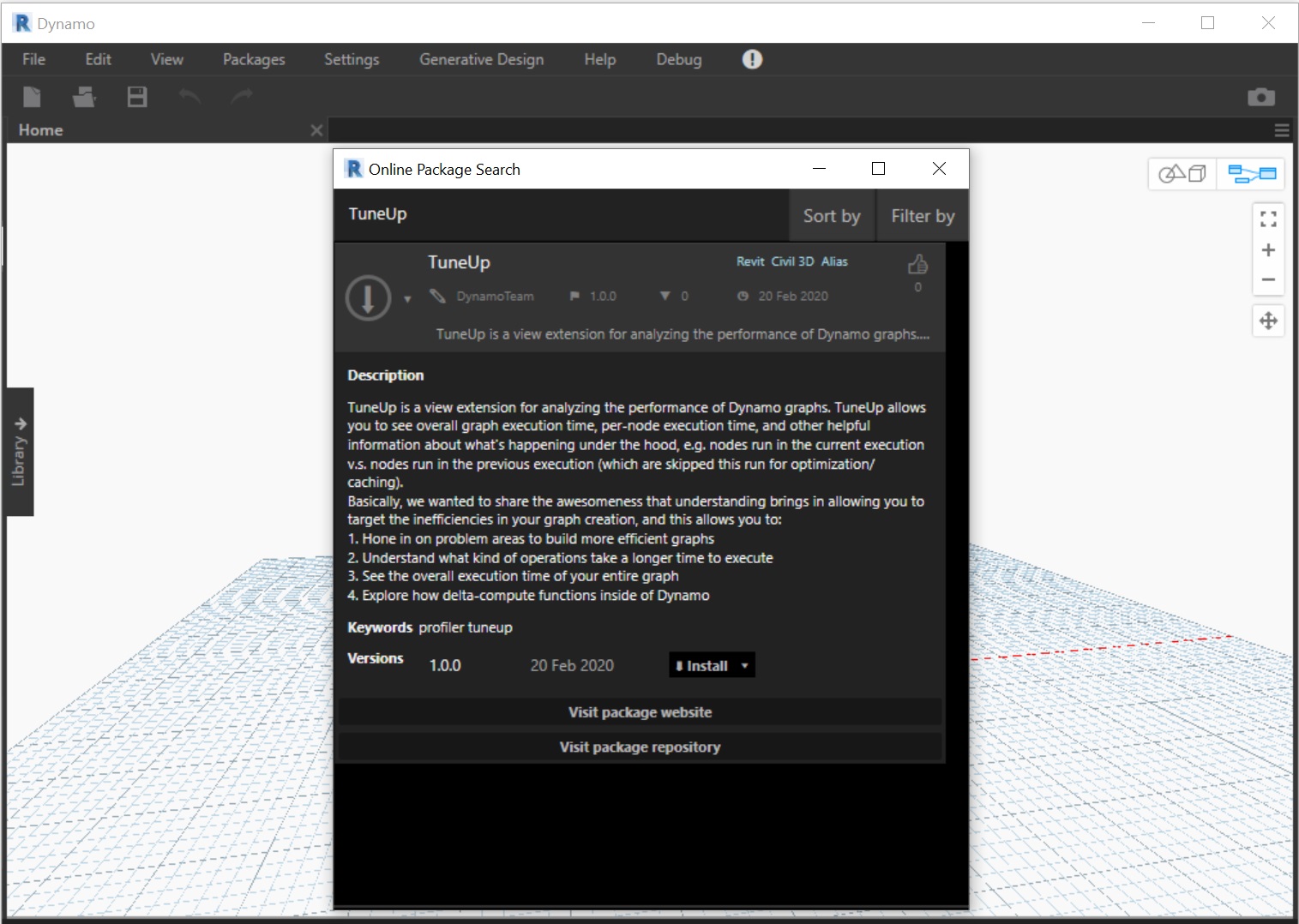

Depending on your version of Dynamo, the easiest way would be to use the Tube Up extension. :smile:

The tune up extension would be a preference because it gives you run time of each node and the overall run time. So you can concentrate on areas that will give you the most benefit from a time point of view(eg You could work to refine a node/code that takes 10 seconds to run to take it to 8 seconds when it would be better to work on the node/code that takes 10 minutes to run to refine that).

There is no nodes to use : a simple click . i just see because i am using now revit 2021

For those who didn’t find the package info. Here it is.
