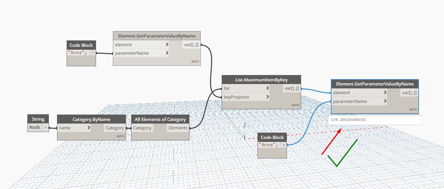

Hi Everyone! I’ve learned a lot from this forum and still!. . . . So, i have this problem: Need to get the highest value from a list (Roof Areas), so i’ll be able to put it in a Schedule.

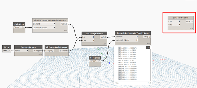

This is what i’ve done:
the node to get the value maybe could be “SetDifference” as read in some post, but to be honest, i don’t know how to use it. Thanks in advance!
