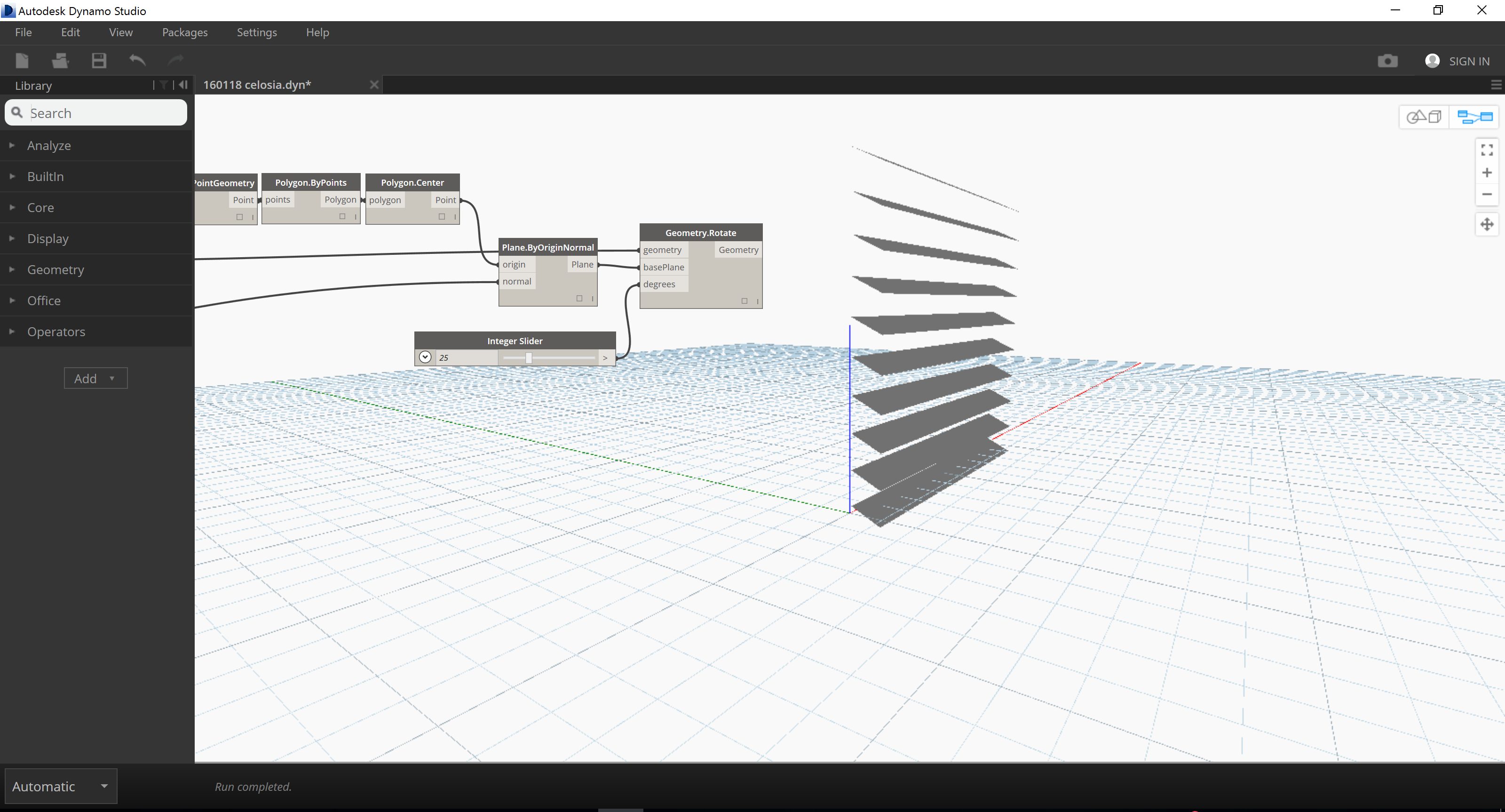

celosia horizontal dynamo 002 I’m working with a program for generating the periodic rotation of an element. For this I need to generate a value (eg 10) which is then transformed into the time ( eg 20) and thus to reach a final number . It is not the same as a list , but need a number that is constantly changing.
20160214-2
Do you mean like having a rotation angle for each hour of the day?
Hi Dimitar, I mean exactly that, but whit a “play and stop button” for example (not with a slider).
This is what I have by now.
