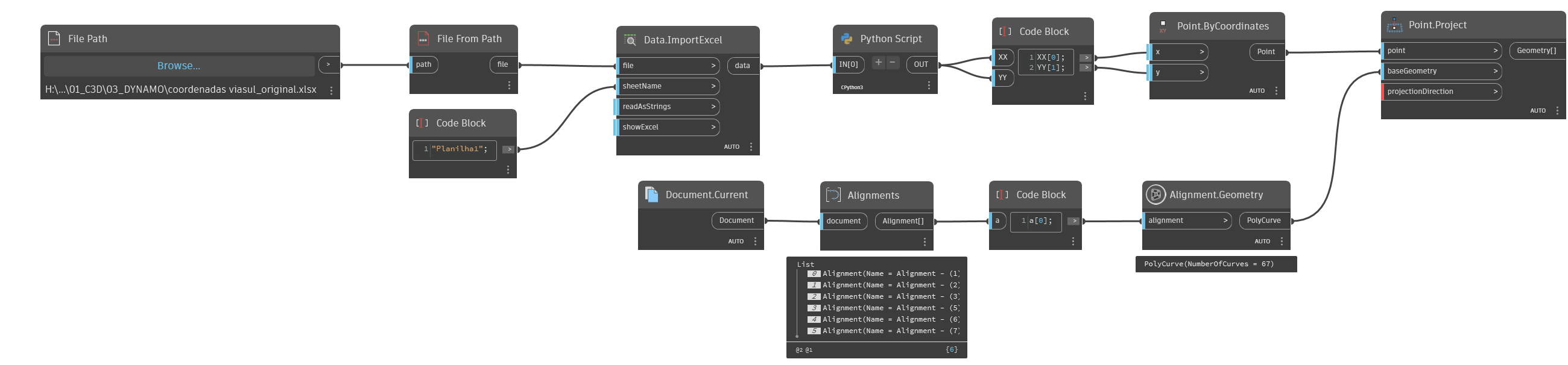

I need to find the alignment station closest to the points I have. I thought about projecting the points onto the curve, but one way to find that is to use the “Point.Project” node, but I don’t know what to put in the “projectionDirection”. Would anyone know how to help me?
Instead of projecting the point onto the curve, try the Geometry.ClosestPointTo node.
Hi @andre.demski,
Have you tried the Alignment.StationOffsetByPoint node?
Thank you very much!
I had seen this node but I thought it would return the station only if the point was coincident with the alignment.
