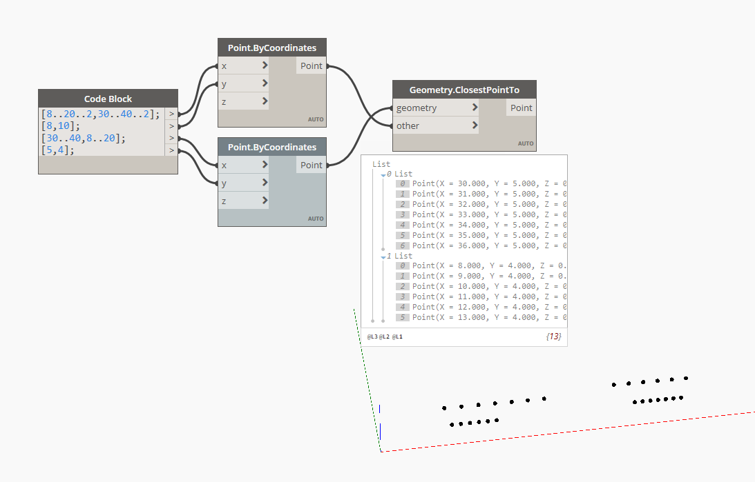

Hey, i think you are looking for this type of solution.
if in list A you have 10 point and list B you have 90points.
then you have to find the 10 point from list B which is closest to 10points of list A.
Regards
Sagar
