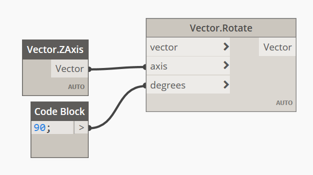

this?
There are two factors in Vector which are Direction and Length.
If you want to compare Direction only, you can do it after using Vector.Normalized which makes length of any vector as 1(same length).
If you want to find the opposite vector, use Vector.Reverse.
