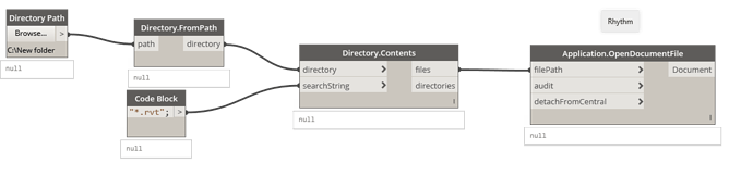

Please read the FAQ and next time add all relevant files (picture, .dyn, trials…)
You can begin like this :
It will open in background the revit files.
It’s impossible to perform actions on files without opening them.
thanks a lot but how could i link the above actions nodes to the models opened in background nodes
Did you really try with the graph I provided above ?
I do not normally do the work of others.
P.S : You maybe need to adjust levels and lacing on nodes. I didn’t try your graph.

You didn’t reproduce the “levels” in the nodes like in my picture.
What are the errors ?
cant perform set parameter by name node it gives NULL
You can’t keep the 3 “actions” on the same graph or you need to use some passthrough nodes.
You have to wait until I update my package. (“SetParameterByName in document” node)

I updated the package Genius Loci.
Don’t forget to divide into 3 parts your graph.
if i won’t to divide the graph, is the pass through node will help or not??
the problem is with the delete parameter part. If you delete the DOR_Number parameter at the same time that you set values, it can not work.
The parameter deletion part must be performed after action 1.
