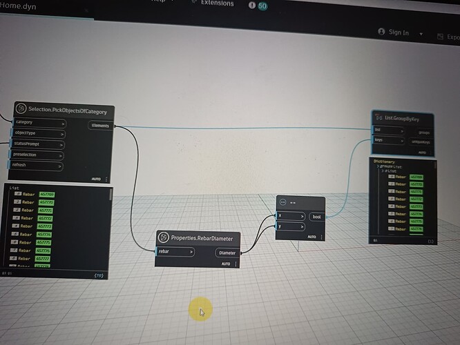

What defines a set or grouping? Where does that data live? How have you tried accessing it? Do you need to filter any of it?
Grouping is pretty straight forward using List.GroupByKey. You just need to have the information you want to group by.

You can group by multiple values, but for something like this it’s probably easier to use the “combined string method”.
"Val1-Val2-Val3-Val4..."What are you attempting to do here? You’re checking if a value is equal to itself and then grouping by that condition, which will always be true. You need to look at all the values you want to group by and match which rebar have all the same property values.
