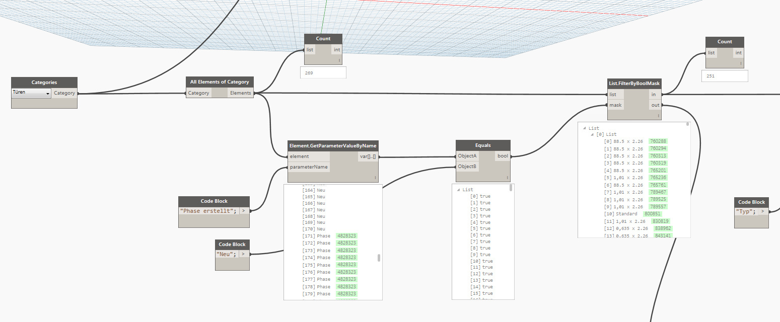

I also used Element.Name to solve the problem, but I still dont understand why the value “Neu” could be showed direktly as string in the first project, Im now comparing two projcts, but they seem to have the same phase settings.

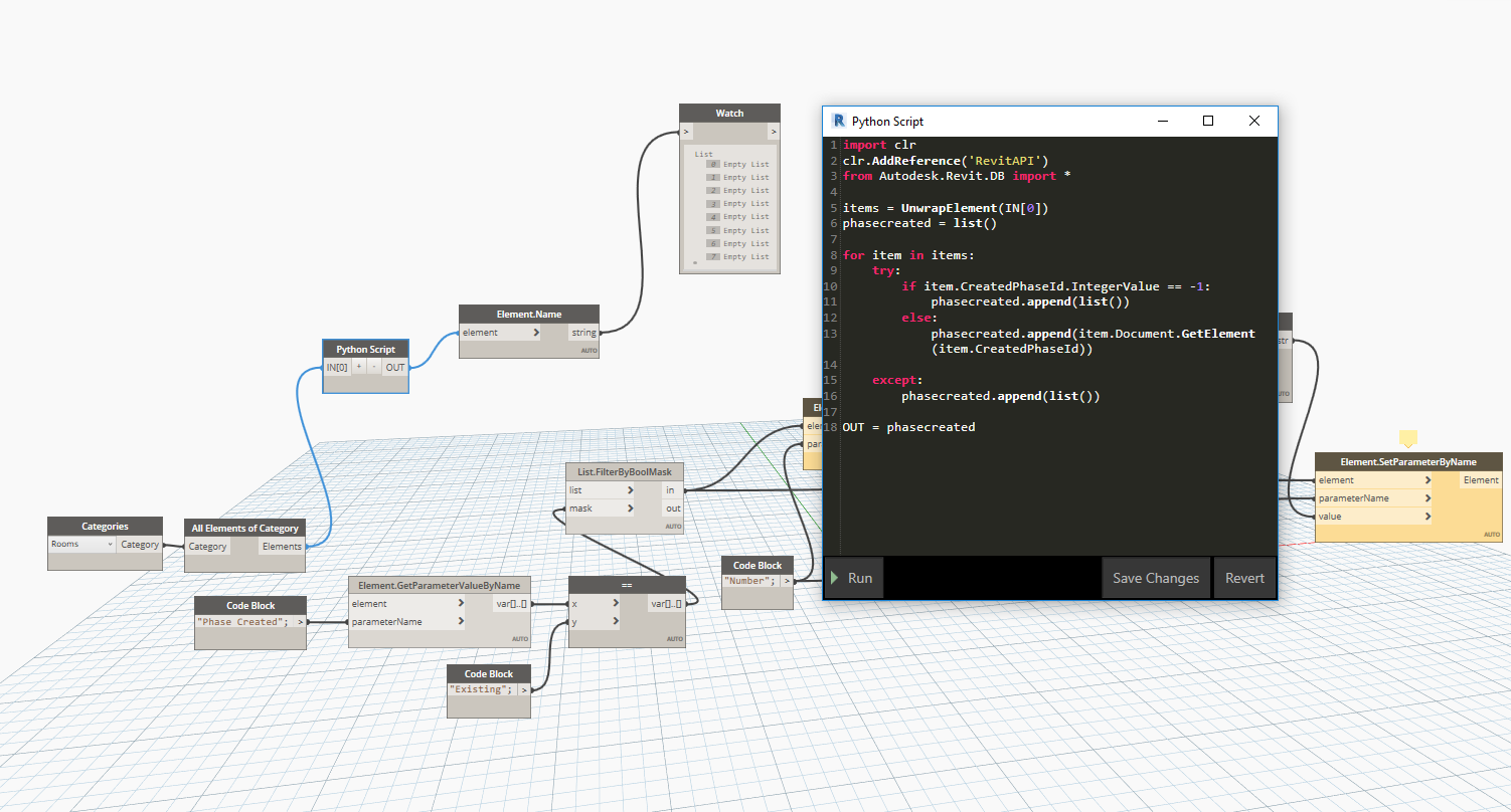

I copied the python script, but in my case I am looking to filter rooms by phase not doors, and I am getting empty lists using this code? Any ideas? I have tried other elements, such as doors, walls etc. and it works.
