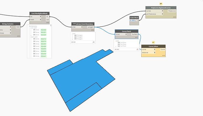

hi all,
I would like to ask how do get the external curve of the combined area surface as the screenshot below, any guide will be much appreciated , thank you !
Create an polysurface and extract the perimeter curves.
Thank you for guidance, I completed the script with surface.byunion and perimetercurves as what you shown , sharing here is the script if is a help to anyone
