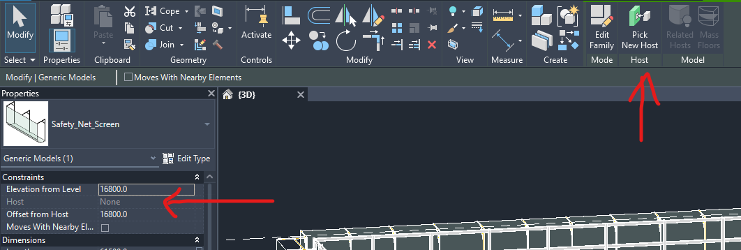

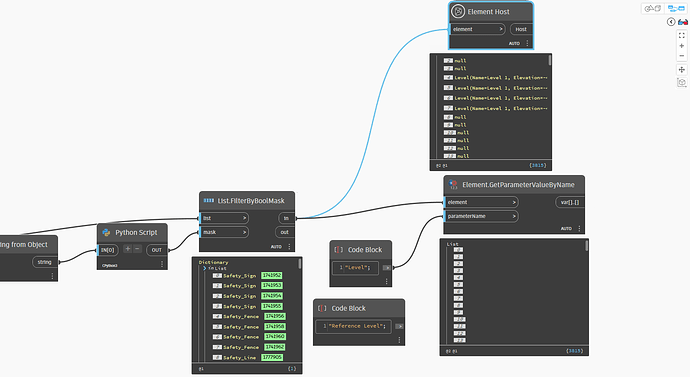

Is there any nodes that can set element host?
So basically i wanted to grouping elements (already placed) based on height level but unfortunately not all elements has “Level” Parameter.
So after i research that i can assign element to any level as host the element. but can i do it with dynamo?.
Thanks in Advance!
Hi @najwan.joan.sv dont hink its possible to rehost, but you could try insert again with the right host i guess :wink:

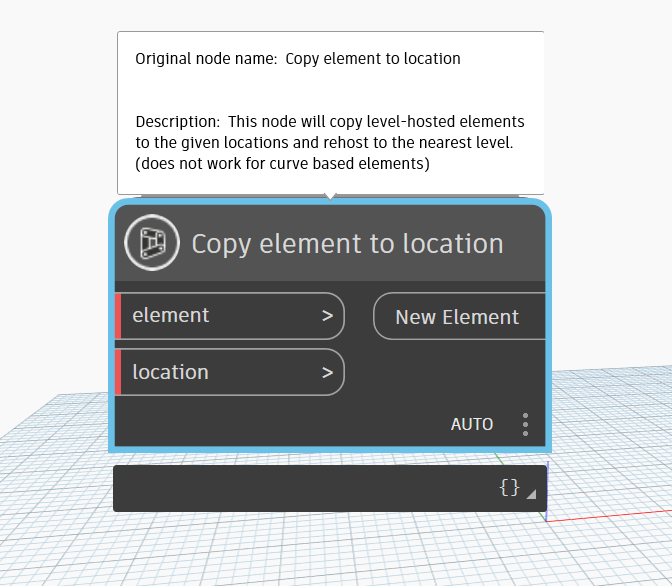

ps not sure if this one here from mepover could help in that case
but guess its depends which familytemplate-categori there have been used, not all have a host parameter…exemple accesories
Yes, it is impossible to rehost, so i tried to change my flow. to placing my instance with hosts input. i found it by using orchid node.
Thanks you very much
