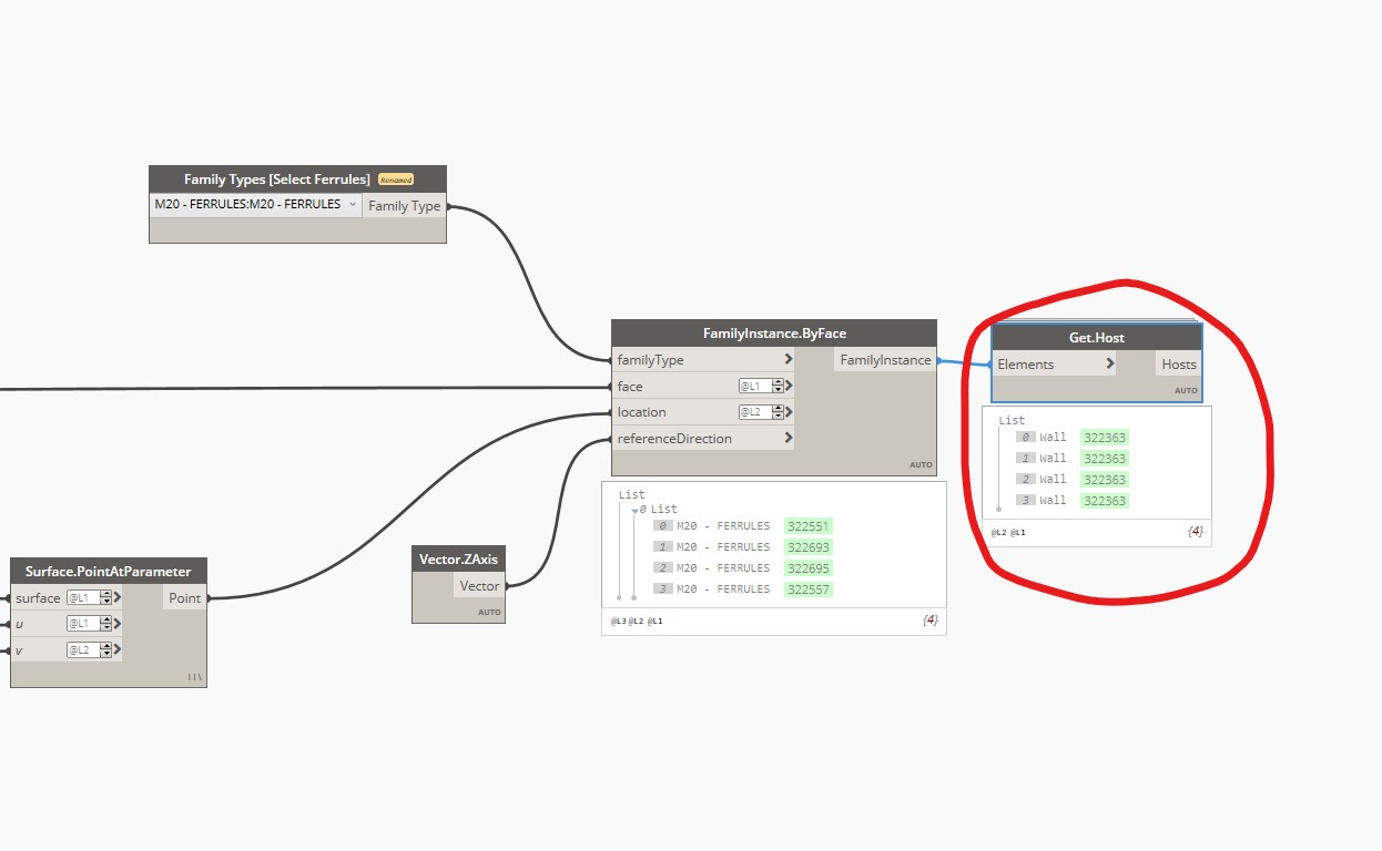

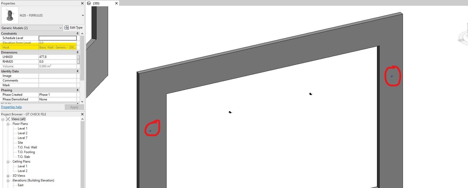

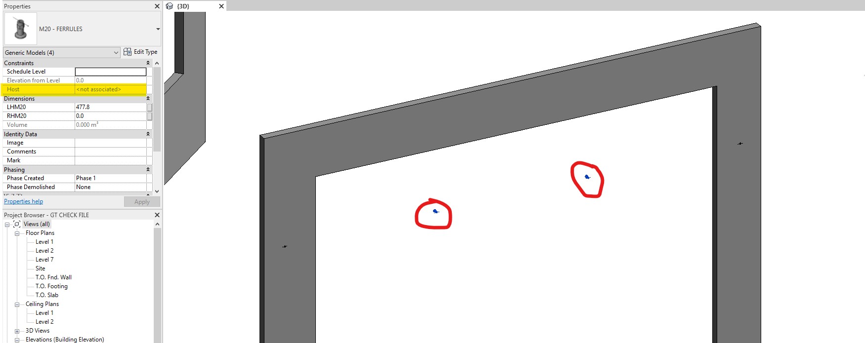

I create program for place a ferrules on face. but i get the host object from that ferrules it’s given a 4 ferrules are host in dynamo. actually i select 2 ferrules in revit that can i see not associated and other 2 ferrules are shown Basic Wall : Generic - 200mm.(See Images)
my problem is how to get hosted object and non-hosted object in dynamo??
I know what you mean, some families have no association:

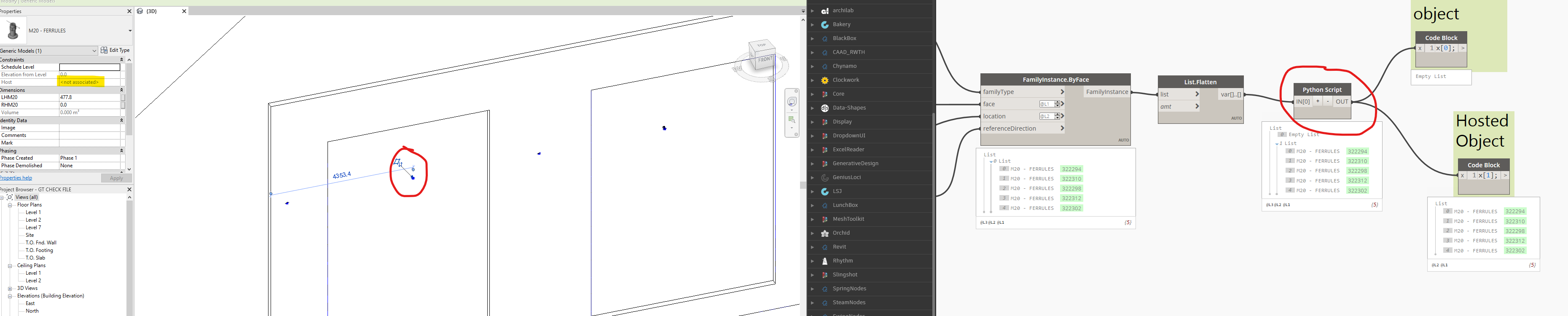

Hi, c.poupin
Thanks for your reply
i use the python code but is not working.(see image)
Any other suggestion.
because Revit waits for the end of the Process (you create instances in your script) to check the hosts if a host is not found Revit changes the status
