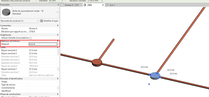

Does anyone know what really should be adjusted?
the paint method does not work with Families, it is necessary to add a Material parameter in the Family
hmm now I understand why no attempt was right.
Thank you for noticing this @c.poupin
