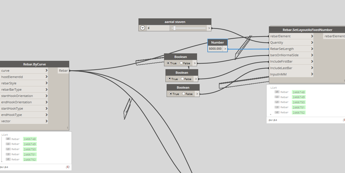

When I’m using reinforcement extensions, I need to fix the Singel rebar to fixed number.
Exemple: I have a beam, after I used the reinforcement extensions. We will see the reinforcement whith single number. Now, I want to change the singel rebar to fixed number. Please to help me!

Your question would be clearer with some illustrations. Please attach what you tried with Dynamo.
is this what you are looking for?
