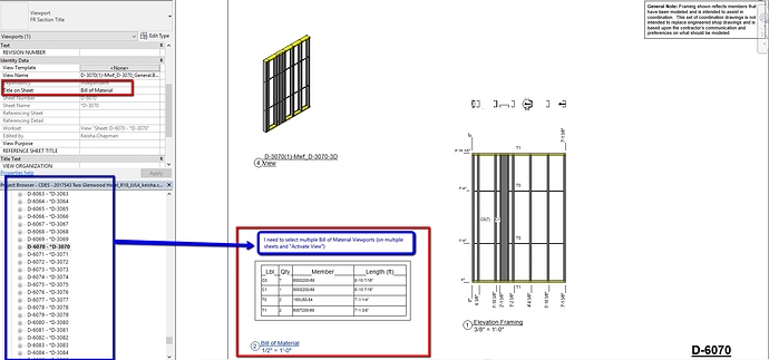

( I ultimately want to “Refresh” all of my Bill of Material viewports for sheets D-6000 to D-6200 at once.
I currently have to open each individual sheet, activate my Bill of Material viewport, then refresh view. This is very time consuming.)

Each sheet has a different “Bill of Material”. I use a program called StrucSoft MWF to frame walls and it generates the “Bill of Material” once we create the shop drawings. If the framing in the walls change I “Activate View” of one of the “Bill of Material” Viewport and use the StrucSoft program to “Refresh View”. This updates the “Bill of Material”. I want to figure out a way to “Refresh View” of all 200 different “Bill of Material” at once. Currently I have to open every single sheet, double click on that particular Viewport (there are 3 different viewports on each page), then “Refresh View”. Unfortunately, I don’t think the method you suggest in this instance will work.
I’m not sure what the plugin you mentioned is. But these views are in the project somewhere. Can these only be updated from within the sheet? If you delete one and undo, does it update?

what is that thing btw, a view yes, a schedule? filtered schedule?
