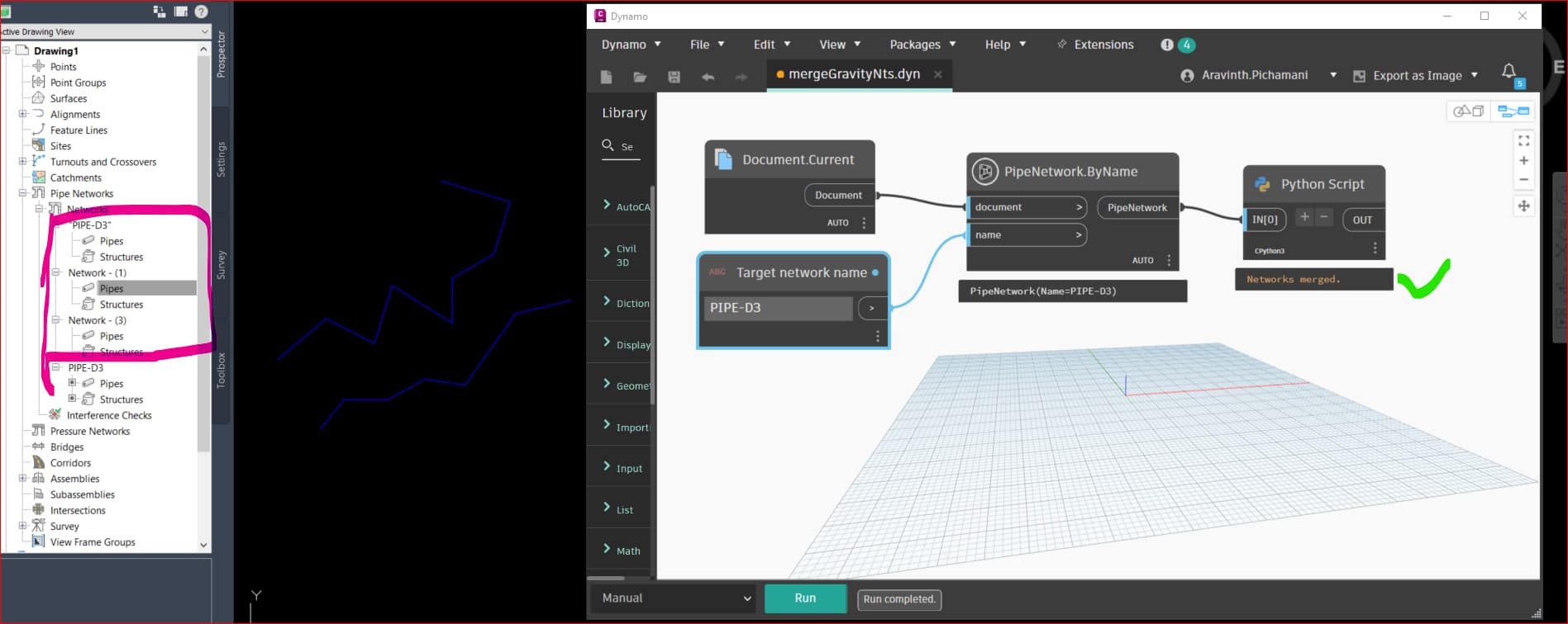

Have any idea for Civil 3D dynamo can merge multiple pipe network into the one?
I have a pipe network called “PIPE-D1” , “PIPE-D2” , “PIPE-D3” and I want to merge these two pipe networks “PIPE-D1” , “PIPE-D2” into a pipe network “PIPE-D3”.
I don’t know which Python scripts are incorrect. Haha!!
before
1.create a pipe network “PIPE-D3” (your target network)
After;-
Check your python version;-
ironpython or Cpython3
The Scripts can choose which Pipe Network to merge? Such as Network -(1) merge and PIPE -D3 to Network -(2), keep the PIPE -D4?? Thank you!
Node (Target Network name) this ur taget name u can write
Hi Could you please send me this dynamo file.
mergeGravityNts.dyn (12.3 KB)
