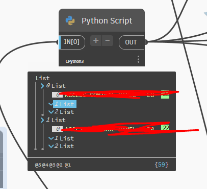

Ok so I managed to to get the numbers I wanted (things went in a different direction since this morning). Now all I need to do is add it in to all the elements within lists they correspond to. Please see below:
I have tried to use the setparametervalue node but I keep getting null values. I try to go to another level but it gives me wonky numbers. Did I set this up wrong?
Your list structure is probably too complicated to work with just list levels or lacing. You might be better off using python or duplicating your values for every item in the sublist so that everything matches structure-wise.
EDIT: It also could be an issue with your nulls in the values list. Are you wanting to write values back to the top level items that show null? It seems like you’re trying to do everything with one list while not actually applying all the same logic to every part of the list. That’s really going to make things confusing and complicated.
